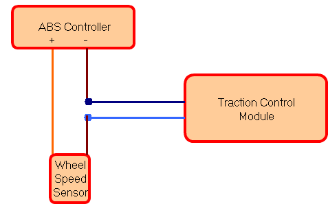

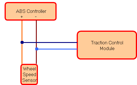

Inductive ABS sensor Wiring Vehicles without an ABS controller can wire the wheel speed sensors directly to the Traction Control module. Vehicles with an ABS controller need to wire the Traction Control module in parallel with the wheel speed sensors.

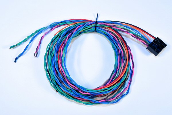

Working on one pair of wheel speed sensor wires at a time, remove some of the plastic insulation from each wire. This is easiest to do with a sharp knife or razor blade. It is best to remove the insulation in a different place on each wire (about 1" / 3 cm apart) so that, even if the insulation fails, the bare wires cannot short out. You only need to remove enough plastic insulation to expose the copper wire.
Strip the ends of the Traction Control wiring harness. With a soldering iron 'tin' both the Traction Control wiring harness wires and the vehicle wheel speed sensor wires which were bared above.
Join the Traction Control wiring harness to the wheel speed sensor wires by holding together and applying heat with the soldering iron. Make sure the connection is secure.
Insulate the join with tape. Self amalgamating tape is recommended, as it will stay water-proof.
When finished use a zip-tie to bind the vehicle wiring and Traction Control wiring harness together to prevent any strain on the soldered joints.

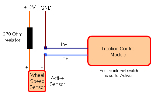

Active ABS sensor Wiring Active ABS sensors need to be wired in series with the Traction Control module. The Traction Control module should be connected to the negative side of the wheel speed sensor wiring.
Active Wheel Speed Sensor Wiring
Identify the negative wire from the wheel speed sensor. Cut the wire, strip and join to the Traction Control module input. The polarity of the wires from the Traction Control module is not important. Solder the joint and use heat-shrink to ensure a water-proof connection, then use zip ties for strain relief, and finally protect from abrasion with electrical tape.

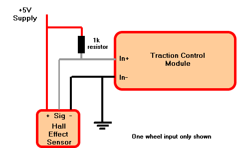

Hall Effect Sensor Wiring For Hall effect sensors wire the Traction Control wheel speed sensor inputs negative to ground and the positive side to the wheel speed sensor signal line.
The ABS sensor type switch should be off. The sensor power supply may be either 5V or 12V depending on the sensor used - check with the sensor manufacturer.
Active Sensor with no ABS Controller For active ABS sensors without an ABS controller, each sensor should be powered from battery voltage via a 270 ohm resistor to the positive side of the sensor. The negative side of the sensor is wired to the Traction Control IN+, and the Traction Control IN- wired to ground.
The ABS sensor type switch should be on. The resistor power rating is not important - a typical 1/4 watt resistor will work.

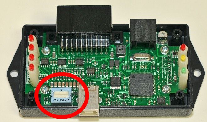

Traction Control ABS Sensor Type
The traction control module uses an internal switch to select what ABS sensor type is in use. The switch is located inside the traction control case next to the USB connector.
For inductive, hall effect and other sensor types the switch should be off (the white slider should be towards the outside of the circuit board). This is the factory default.
For active ABS sensors the switch should be on (the white slider should be towards the center of the circuit board). There may be a green plastic cover over the switch. In this case, peel away the green plastic to change the switch position.
