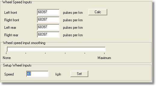

Wheel Speed Inputs
Wheel speed inputs are calibrated by the number of wheel speed sensor pulses per revolution and number of tire revolutions per unit distance, which gives pulses per unit distance. These values can be calculated by using the Calc button, set while driving the vehicle using the Set button, or entered directly.
Wheel speed input smoothing sets the number of wheel speed pulses to average when calculating wheel speed. It is recommended to leave this as none.
Setup wheel inputs will calculate the wheel pulses when the vehicle is moving. A steady speed on a smooth road should be used when setting the wheel speed inputs using this method. |
