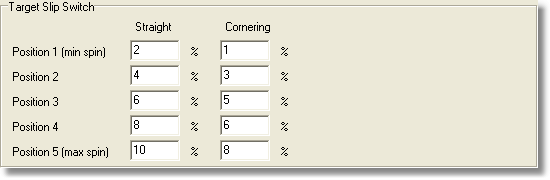

Target Switch
Different percentage target slip values can be assigned for each position of the target slip switch. The first position is always off, and then it is recommended that the target slip percentages increase as the switch is rotated. There are two values - one used while the vehicle is traveling in a straight line, and another when cornering. Generally the cornering target slip needs be lower than the straight line slip, as the tires will not accept as much longitudinal slip if there is a lateral (cornering) force on the tire. See Setup 2 for how cornering is determined.

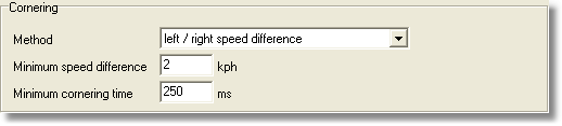

Cornering When cornering the tires will not accept as much longitudinal slip if there is a lateral (cornering) force on the tire. Cornering can be determined by comparing the wheel speeds on the left of the vehicle with the wheel speeds on the right of the vehicle.
Method is which wheel speeds to compare to determine if the vehicle is cornering. Left / right speed difference (recommended setting) uses all four wheels, front uses the two front wheels and rear uses only the rear wheels.
Minimum speed difference is the minimum speed difference between the left and right wheels before the vehicle is determined to be cornering. It is recommended to use 2 kph.
Minimum cornering time is the minimum amount of time the wheel speeds need to be different by the minimum speed difference amount before the vehicle is determined to be cornering. It is recommended to use 50-200 ms.

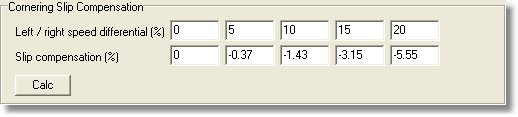

Cornering Slip Compensation When turning a corner, all four wheels travel at different speeds. This will result in a false slip reading unless compensated. The actual wheel speeds when cornering depend on the radius of the corner, vehicle wheelbase, vehicle front and rear track width and the axle speed determination.
It is recommended to use the Calc button to set the values based of common vehicle settings. |
