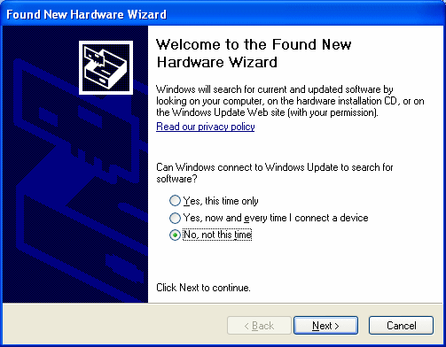

2. When Windows displays the Found New Hardware Wizard, choose the 'No, not this time' option.

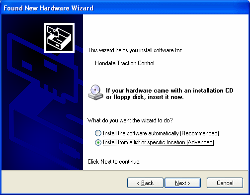

3. Choose Install from a list or specific location.

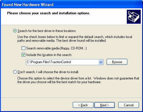

4. Select the Traction Control installation directory. Normally this will be C:\Program Files\TractionControl (Windows XP).
