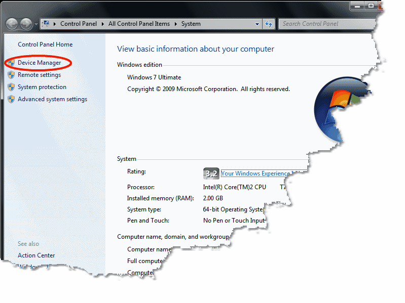

Sometimes Windows will not automatically install the USB drivers, or if the Traction Control has been plugged into the PC before the software is installed, the Traction Control USB driver will be disabled by Windows. In this case you need to manually install the USB drivers.

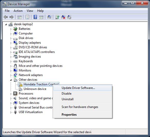

3. Right click on 'Traction Control' (Traction Control may be listed under "ECU Hardware (Hondata) or 'Other Devices') and select 'Update Driver Software...'.

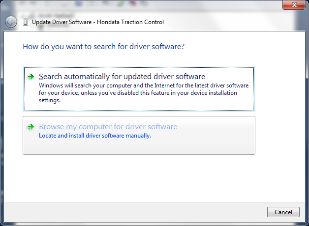

4.Select 'Browse my computer'.

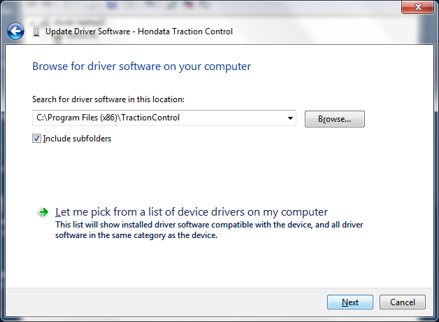

5. Tell Windows to look in the Traction Control installation directory. Normally this will be 'C:\Program Files\TractionControl\Drivers' (Windows 7 32-bit) or 'C:\Program Files (x86)\TractionControl\Drivers' (Windows 7 64-bit).

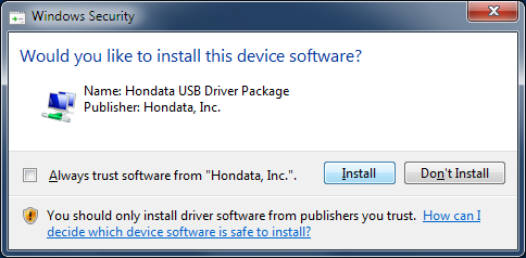

6. Confirm that you want to install the drivers.

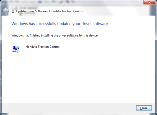

7. Windows will install the drivers.
