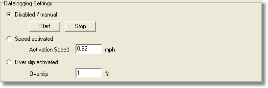

datalog-setup
Datalog settings determine how a datalog is started.  Once a datalog is made, it will not be over-written until the Traction Control module is reset, which usually occurs when the ignition is switched off.

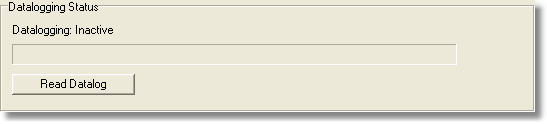

datalog-status
Datalog Status shows the amount of datalog memory which has been used.
Read datalog will read the datalog into the laptop, and also output the datalog as a comma separated value file.

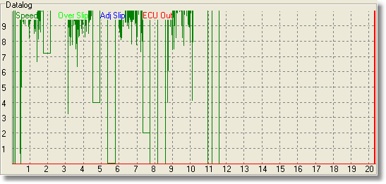

datalog-datalog
The datalog window shows a small graph of the wheel speeds / slip from the datalog for diagnostic purposes.  It is not intended to be a fully fledged graph with zoom and variable control.
