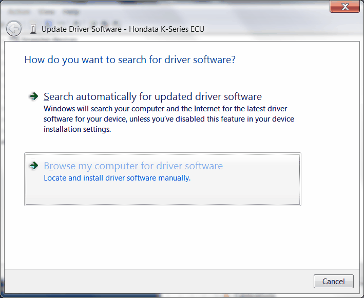

1. After selecting Update Driver Software... from the Device Manager you should see the following window.  Click on Browse my computer for driver software.
usb-di-7-1

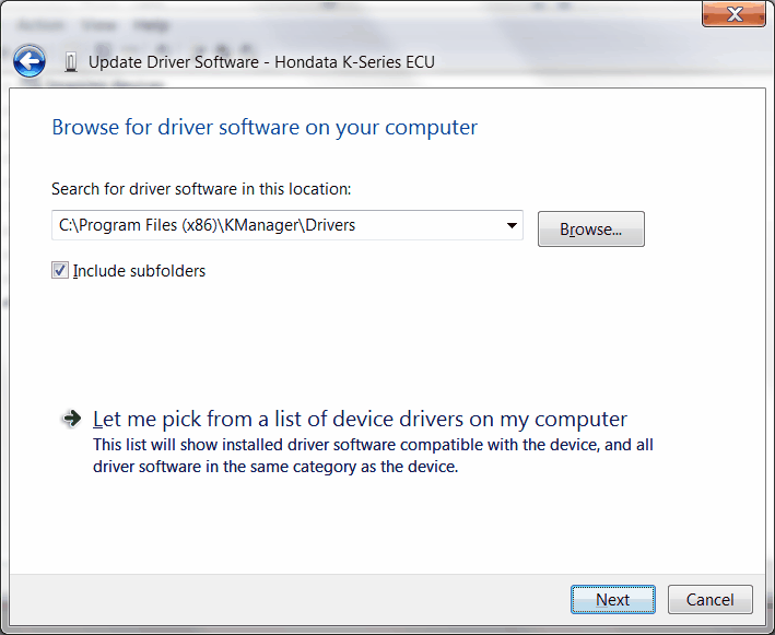

2. Use the Browse button to enter the path to the KManager software installation location. Normally this will be either C:\Program Files\KManager\Drivers (32 bit Windows) or C:\Program Files (x86)\KManager\Drivers (64 bit Windows).
usb-di-7-2

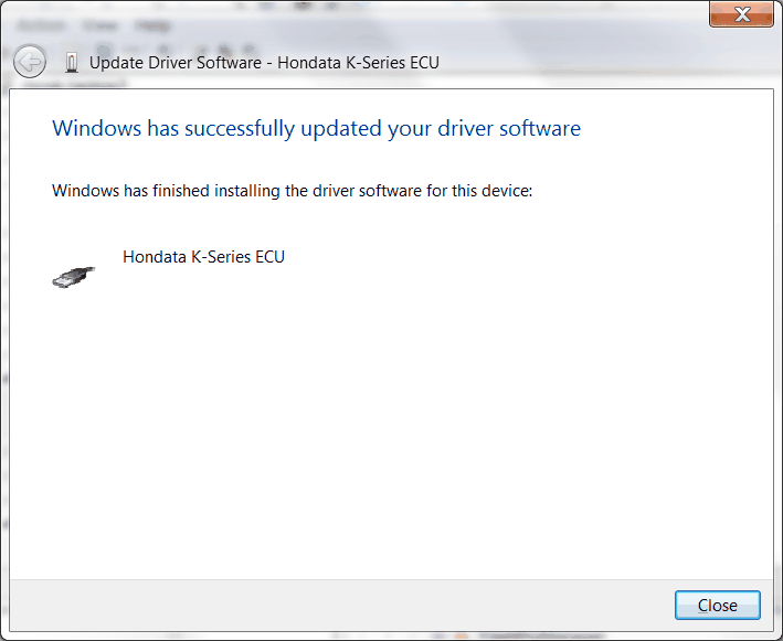

3. Windows will copy drivers, and should display the following message once finished.
usb-di-7-3
The USB drivers are now installed.
