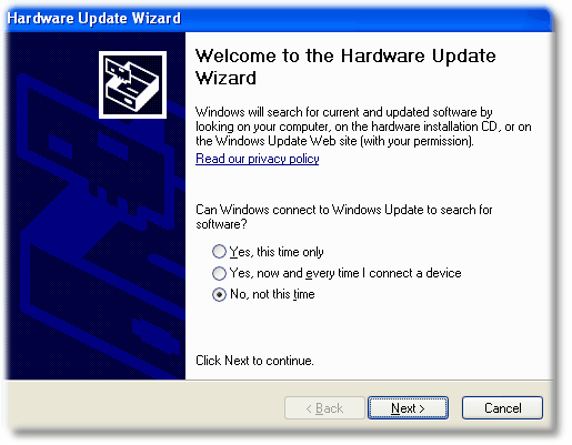

1. After selecting Update Driver... from the Device Manager you should see the following window.  Select No, not this time and click on Next.
usb-di-xp-1

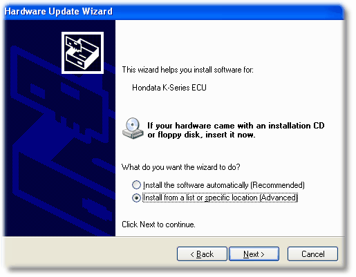

2. Select Install from a list or specific location (Advanced) and click on Next.
usb-di-xp-2

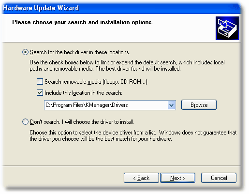

3. Enter the path to the KManager software installation location (normally this is C:\Program Files\KManager\Drivers).
usb-di-xp-3

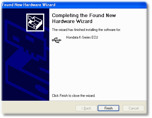

4. Windows will copy drivers, and should display the following message once finished.
usb-di-xp-4
The USB drivers are now installed.
