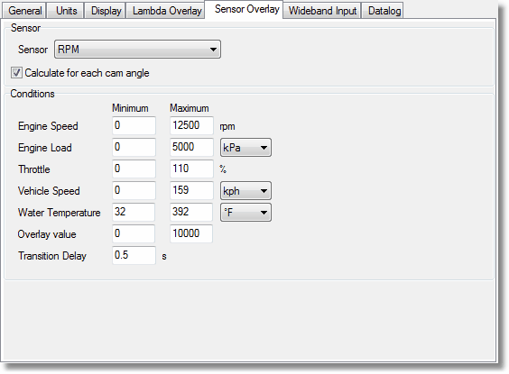

This tab contains settings for a table sensor overlay.
Sensor - selects which sensor to overlay.
Calculate for each Cam Angle - when checked, records the sensor for each individual cam angle table, rather to collectively for all tables.
Conditions - determine what conditions must be met before the sensor is recorded.
Some sensors are translated when recorded:
Knock Count is translated so that each time the knock count is increased the overlay cell value is increased by one.
Knock Level is translated to show the ratio of knock level to knock threshold.
