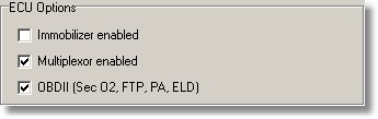

Immobilizer
If the immobilizer light on the dash blinks (green key symbol) then you may to re-enable the immobilizer.
parameters-features
If the ECU does not match and vehicle (key and immobilizer transponder) then it is possible to disable the flashing immobilizer symbol simply by unplugging the immobilizer transponder (located on the ignition switch barrel).
