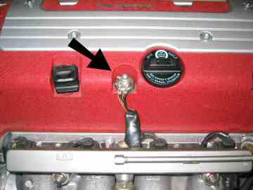

Engine Ground
It is very important that the ground from the wiring harness to the engine (G101) makes good electrical contact with the cylinder head.  Otherwise the return path for the sensors, ignition and VTEC may be through the ECU case to the vehicle body, which may damage the ECU and/or programmable board inside the ECU.  Note that KPro/S2000 users do not need to change the ground location as the S2000 ground is already in a good position on the cylinder head.
groundlocationsm
The recommended positions for the engine ground is either on a stud attached to the cylinder head (pictured) or the transmission end of the cylinder head (not pictured).
