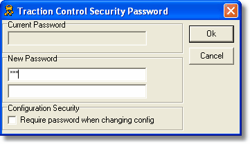

![]() Entering a Security Password
Entering a password Leave Current Password empty, as by default the security password is empty. Enter your new password twice to ensure that the new password has been entered correctly.
Changing Your Password Enter your current security password, or leave blank if no password has been entered, and enter your new password twice to ensure that the new password has been entered correctly.
Removing Your Password To remove a password enter your current password and leave the new password fields empty.
Upload Security Check Require security password when changing config to ask for the security password each time the Traction Control configuration is altered.
Forgotten Password If you have forgotten or lost your security password, it may be sent to the registered owner's email address. |
