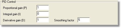

Using PID Control
It is recommended to set the proportional gain to 1.
Since traction control is usually short acting, the error of time tend to be small, and integral gain can usually be set to 0 so that it is not used.
The derivative term will tend to dampen the ECU output as the wheel slip increases sharply. This will reduce the tendency for the traction control to over shoot the target and oscillate. A derivative gain of 0.1 to 0.5 normally works well.
The derivative smoothing factor should be set to give the least oscillation with the derivative term. Normally 2 to 5 works well.
Values of P=1, I=0, D=0 will give the same output as the non-PID control algorithm.
