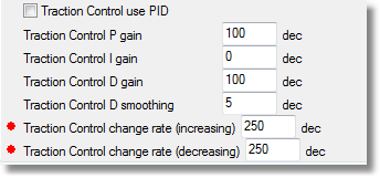

Smoothing can use with PID control or a maximum change rate to smooth the operation of the traction control retard.
If use PID is enabled, then the P, I and D gains are used plus the D smoothing. Otherwise the change rate increasing and decreasing are used. |
