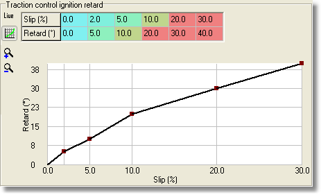

Ignition Retard sets the amount of ignition retard when wheel slip occurs. Values are interpolated between columns.
