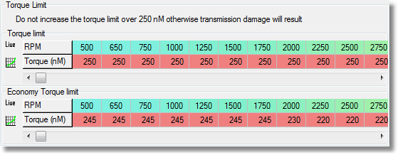

Some vehicles have a torque limiting table or tables for transmission protection.
Note that CVT transmissions will be damaged by either 'power braking' at any torque level (holding the vehicle on the brake while opening the throttle pedal) or by increasing the torque past about 250 nM.

Torque Limit Overall torque limit as percentage torque (0-100%).
