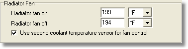

Radiator Fan
This sets the temperature when the radiator fan switches on and back off. The 'on' temperature should be approximately 3°C/5°F higher than the 'off' temperature.
Normally temperature reading from the second coolant temperature sensor is used to switch on the radiator fan. This sensor is located in the bottom of the radiator and senses the return coolant temperature - which will be less than the cylinder head coolant temperature. If you wish to use the cylinder head coolant temperature sensor to activate the radiator fan, uncheck this box.
Note that the stock thermostat starts to open at 85ºC/185ºF, and is open fully at 90ºC/195ºF. If you set the radiator fan on or off temperature below the thermostat fully open temperature then it is likely the radiator fans will always be on during normal engine operation.
