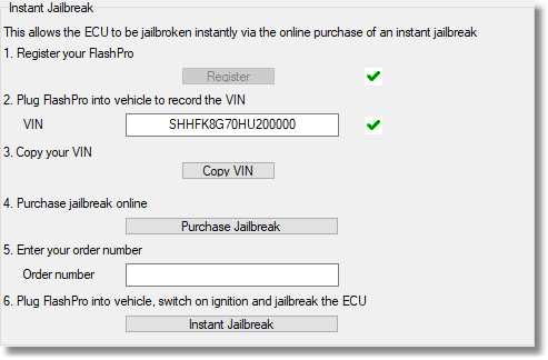

From the factory FK2/FK8 ECUs cannot be programmed over OBDII and must be unlocked ('jailbroken').
Jailbreak Status
This shows if the ECU has been jailbroken.
Instant Jailbreak
An 'Instant Jailbreak' allows your FlashPro to jailbreak your FK2/FK8 ECU in your vehicle without the need to remove the ECU.
For an instant jailbreak you need to purchase an 'Instant Jailbreak' from the Hondata website using you VIN. https://www.hondata.com/instant-jailbreak
Then use the order number from the online purchase to start the jailbreak.
