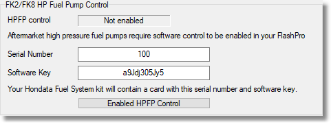

If the FK2/FK8 high pressure fuel pump is changed then the ECU must use different parameters to control the fuel pump.
It is important to note:
1.5T with Hondata Fuel System
For the 1.5T with the Hondata Fuel System, a modification is available which alters ECU setting for the fuel system. It is possible to run the stock fuel system without disabling this modification.
HPFP Control
The HPFP control is enabled via the use of a software serial and key, which is distributed as a card with the Hondata Fuel System.
