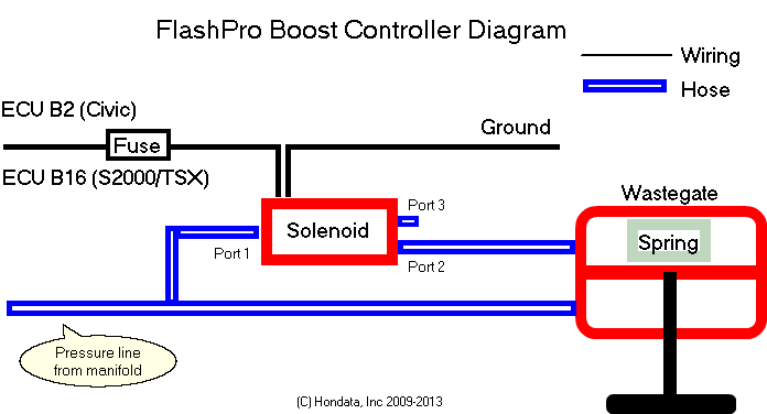

While almost any solenoid can be used for boost control, it is recommended to use a 3 way solenoid designed for boost control.
Solenoids can either be normally open or normally closed. A normally open solenoid has the advantage of not running until boost needs to be increased, but has the disadvantage of not controlling boost at all if the solenoid or hoses fail. An ECU boost cut is recommended to prevent damage if this occurs. A normally closed solenoid will run more often but will limit boost to the spring pressure if a component fails.

It is recommended to use an external wastegate with two ports (on both sides of the diaphragm). This is by far the most common type of wastegate. For other configurations typically the boost control solenoid operates as a bleed valve, venting pressurized air from the wastegate to the atmosphere.
There are several different pressure sources which can used to control the wastegate:
Each pressure source has advantages and disadvantages - try using a pressure source from the intake manifold first, and then experiment with other sources if the boost is not stable.

The solenoid has two wires, with no polarity (it does not mater which wire is used for each connection):
