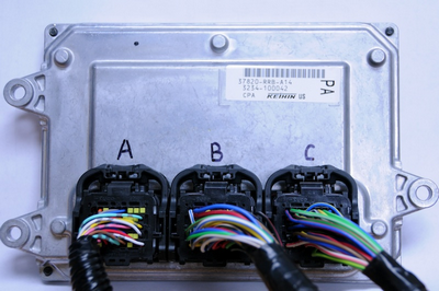

ECU connector wires are normally referred by the connector and pin. eg C27 refers to pin 27 of connector 'C'.
Important ECU Pins
Civic Connectors The ECU connectors are color coded:

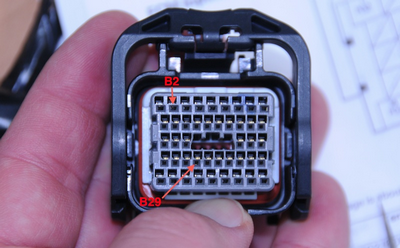

Pins Each connector has pins numbered from 1 to 40 organized into five rows. The pin number is visible on the wire side of the connector once the plastic cover is removed.
For each connector large pins are used on the top and bottom rows; small pins are used in the middle three rows.

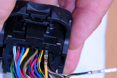

To either insert or remove connector pins you first must slide the white plastic surround upwards slightly to unlock the pins.i
Inserting Pins

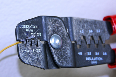

Crimp the pin onto the wire using a crimp tool. We recommend a Molex tool with a 1.6mm diameter crimp.
First ensure you have the correct cavity - it is very difficult to remove a pin once in place. To insert the pin push it in with the open side of the crimp upwards, until the pin clicks in place.
Once finished move the connector white plastic surround back into position to lock the pins in place.

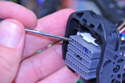

Removing Pins
The tool is inserted from the ECU side of the connector to lift a sprung plastic catch while pulling on the wire from behind. Do not use much force on the wire, otherwise to pin will dig into the plastic catch and the pin will be very difficult to remove. |
