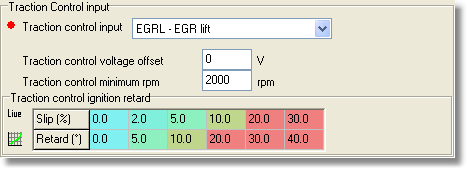

Traction Control options are available from the Traction Control entry in the Calibration window.
Input selects the ECU input pin from the Traction Control module. Note that ECT2 is not recommended as it is not updated internally in the ECU fast enough for effective traction control.
Voltage offset should be zero unless you have a wiring ground problem.
Minimum rpm determines the minimum engine speed the traction control will operate at. Set this above idle and below the minimum speed which you would expect wheel slip.

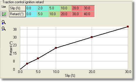

Ignition Retard sets the amount of ignition retard when wheel slip occurs. Values are interpolated between columns. |
