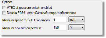

VTEC Options
VTEC oil pressure For JDM engines and JDM ECUs disable the VTEC oil pressure sensor.
P0341 This error is generated if the phase difference between the intake and exhaust cams is more than about 5 degrees. Some after market camshafts will generate this error.
Minimum Speed - is the minimum vehicle speed before the cams switch to the high speed lobe.
