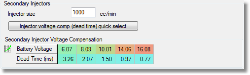

Secondary Injectors
This specifies the size and dead time characteristics of the secondary injectors.
staged_inj_size
It is important to use accurate values for the injector size and dead time.  To test the values, set the activate rpm and load to a low value (3000 rpm, 10 kPa) and free rev the engine slowly until the secondary injectors activate.  If the lambda goes rich or lean, then the size or dead time values are not correct.  Generally the dead time parameters make a larger different at light loads, and need to be accurate without 0.05 ms.

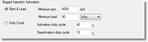

Activation
The secondary injectors can be activated by rpm & load or by duty cycle.  It is recommended to use rpm & load for testing and duty cycle for final operation.
staged_inj_act
Rpm & Load - specifies the minimum rpm and load for the secondary injectors to operate.  Hysteresis is built in to prevent rapid cycling.
Duty Cycle - specifies the minimum duty cycle for the primary injectors for secondary injector operation.  The deactivation duty cycle is based on the duty cycle with only the primary injectors firing.
