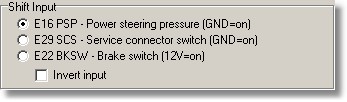

Selects the input trigger for the sequential shift engine cut. The behaviour of the input may be reversed (inverted). Note that not all ECUs have the internal circuitry to support all the input options.

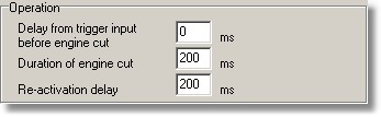

Sets the conditions under which the sequential shift engine cut operates.
Delay from trigger is the delay from the ECU receiving the shift cut trigger and the engine output cut, measured in milliseconds.
Duration of engine cut is the length of time the ECU cuts the engine output, measured in milliseconds.
Reactivation delay is the time delay before another signal from the input trigger will activate the shift cut, measured in milliseconds.
All time values have a resolution of 10 ms.
