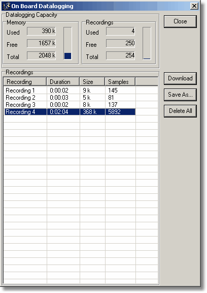

To download datalogs from the KPro to a laptop select the 'Datalogging' tab of the KPro Window, or use the 'Download from ECU' command.
datalogging-download
To download a datalog select the recording and either use 'Download', which downloads the recording into KManager, or 'Save As...' which downloads the recording and saves to disk. Datalog recording downloaded into KManager can subsequently be saved to disk as well.
'Delete All' is used to delete recordings once they are downloaded.
