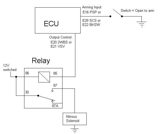

Arming Input - specifies which ECU pin is used to arm nitrous.
Invert Arming Input - reverses the arming input so that nitrous is armed when the switch is on.

Output Control - specifies which ECU pin controls the nitrous solenoid. Important: the ECU cannot sink enough current directly to control a solenoid. A relay must be used between the ECU and solenoid to prevent damage to the ECU.
Invert output - reverses the output pin behavior. Note that this does not alter the electrical configuration of the pin (usually the pin is grounded when the output is active).

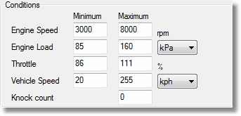

Conditions - specifies the conditions which must be met before the output is switched on.
Maximum throttle should normally be over 100% to ensure the output is triggered if the TPS reads over 100% at full throttle.
Maximum vehicle speed should be set to 255 kph to ensure the nitrous does not shut down at 158 mph / 255 kph.
Knock count sets the maximum knock count, above which nitrous will shut down. A count of 0 disables the shutdown.

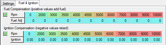

Fuel & Ignition
This specifies the fuel and ignition changes when nitrous is active.
Note that fuel may be removed (useful with water/alcohol injection) by entering a negative value.
Ignition timing will be retard if negative values are used, and advanced if positive values are used.
