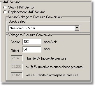

MAP Sensor Selection Either the stock MAP sensor or an alternate sensor can be used. If the stock MAP sensor is selected then the stock voltage to pressure conversion is used - you do not need to enter anything in the Voltage to Pressure conversion section of the tab.
Quick Select Selects from a number of pre-set voltage to pressure conversion parameters. If the MAP sensor you are using is not listed then you will need to enter a custom conversion.
Scalar The scalar (multiplication value) for the MAP sensor voltage to pressure conversion. For more information see scalar & offset.
Offset The offset for the MAP sensor voltage to pressure conversion. For more information see scalar & offset.
Full Scale Values This calculates the full scale pressure readings at in mbar and lbs boost. Note that these values are calculated at 5V and may not be achievable due to differences in supply voltage from the ECU. See Boost Limit for more information.
Atmospheric Pressure Values This calculates the expected voltage at standard atmospheric pressure (1013.2 mbar). Note that not all MAP sensors will report atmospheric pressure under key-on-engine-off conditions.

A MAP sensor converts a pressure reading into a voltage output. There is a relationship between output voltage and pressure which determines the pressure range of the MAP sensor. This relationship should be linear (otherwise the MAP sensor is poor quality) and therefore can be described using a linear equation.
The scalar and offset describe the pressure / voltage equation. These values may be determined by measuring the voltage output from the MAP sensor and plotting on a graph, or from the specifications of the MAP sensor.
If you do not know the scalar of offset for a MAP sensor then please do not guess.
Boost Limit
The boost limit operates when the manifold pressure exceeds a pre-set value. The value must be within the range of pressure that the MAP sensor can read, with a margin for production tolerances on the ECU sensor output voltage and MAP sensor. You must not assume that a 5V MAP sensor will reach 5V output at maximum pressure. e.g. the boost limit is set to 11.3 lbs for a stock MAP sensor, which equates to an output voltage of 4.96 V from the MAP sensor. This is too close to the maximum output of the MAP sensor for reliable triggering of the boost cut (the MAP sensor might never exceed 4.9 V for instance). It is recommended that a 1 lb or 0.2V margin is left between the boost cut and MAP sensor maximum pressure reading.
5 Bar MAP Sensors
While any linear MAP sensor is supported, the fuel, ignition and cam angle tables are only currently mapped to 28 lbs. For MAP sensors greater than 3 Bar you will need to alter the table load index (see Changing Table Index Values) to allow the greater MAP sensor range to be utilized. The number of columns will not change.

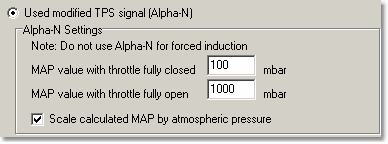

Modified TPS signal (Alpha-N)
Note: This option is designed for use with race vehicles only.
This option replaces the MAP sensor with the TPS sensor for table indexing. It is designed for use with individual throttle bodies, where the MAP sensor does not accurately reflect the engine air flow. In combination with altering the table load index values, the TPS can be used as the table index.
Map value with the throttle closed - is the assumed minimum MAP pressure equivalent.
Map value with the throttle open - is the assumed maximum MAP pressure equivalent. Normally this will be close to atmospheric pressure.
Scale calculated MAP by atmospheric pressure - scales the resultant table index by the current atmospheric pressure (based on standard pressure being 1013.25 mbar), in order to partially compensate for changes in air pressure and elevation.
Warning: Manifold pressure over atmospheric will not be read. Do not use the Alpha-N setting for forced induction.
