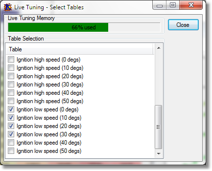

Menu Table Selection
Alternately, tables may be selected from a list available from the Online menu.
live-tuning-select
