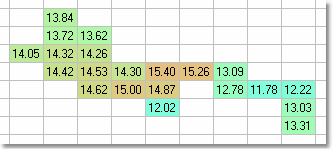

Lambda overlay allows you to over the lambda reading from datalogging over the fuel tables
You can change the Lambda Overlay either from the toolbar or the menu:
Also see the Lambda Overlay options in the Settings Window
The following overlay views are available:
Normal - displays the normal fuel and ignition tables.
Lambda - shows the recorded lambda readings on the fuel tables.
Fuel Adjustment - shows the estimated adjustment to the fuel table necessary to alter the measured lambda to meet the target lambda.
Target Lambda - shows the target lambda as entered in the Settings Window
