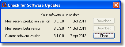

Check for Updates
This command checks for updates on the Hondata website.
Important: When installing updates make sure that the ECU is not plugged into the PC.
checkforupdates
Updating KManager will update the KManager application, ECU software and the base calibration files.
If you do not have Internet access on the tuning PC, then you will need to download updates from the Hondata website, transfer the update files to the tuning PC, then run the update on the tuning PC.
