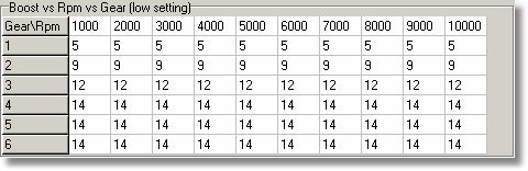

A gear based duty cycle uses two additional tables to determine duty cycle. First the Boost vs Gear table is used to find the target pressure for the current gear, then the Pressure vs Duty Cycle table is used to calculate the solenoid duty cycle to reach the target boost.

Boost by Gear
These tables set the target boost for rpm and gear. The pressure units are determined by the combo box under Settings.
