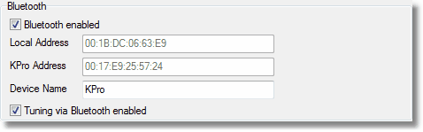

Bluetooth Options
Bluetooth options are available from the KPro window under the Bluetooth tab.
Bluetooth Options
bluetooth-options
Bluetooth enabled - enables or disables Bluetooth on the KPro.
Local Address - the Bluetooth address of the Bluetooth Radio on the laptop.  If this is blank, then either there is no Bluetooth Radio available or a Bluetooth Stack other than Microsoft is being used.
KPro Address - the Bluetooth address of the Bluetooth Radio on the KPro.
Device Name - the KPro Bluetooth name.  Note that many devices do not show the name until after the connection is made or use a generic name such as 'Server'.
Tuning via Bluetooth enabled - if checked then it is possible to datalog, change some settings, upload etc over Bluetooth using the laptop.  The speed is approximately 40% of that of USB.

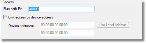

Bluetooth Security
bluetooth-security
Bluetooth Pin - this is the PIN code which usually must be entered from a mobile device or laptop when connecting to the KPro.  Note that Windows can try to connect up to three times without asking for a PIN code, which fail, before asking the user for a PIN code. Connections made under Bluetooth Low Energy do not use PIN codes; therefore Tuning via Bluetooth is disabled for Bluetooth Low Energy.
Limit access by device address - this will limit connections to the KPro to those listed under 'Device Addresses'.  This is the most secure option.
