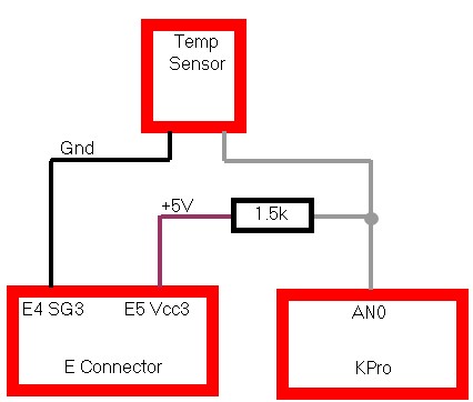

Wiring A 1.5k ohm (1500 ohm) 1% resistor must be used between the analog input and 5V. The 5V source can be any of the ECU VCC outputs. The sensor can be grounded to any ECU signal ground (SG3 in the picture).
A suitable resistor is a 1% 1/8 watt metal film resistor by Vishay/Dale, part #RN55D1501FB14 |
