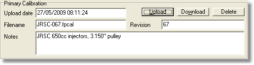

Storing a calibration on the FlashPro
It is possible to upload a calibration to the FlashPro, which can then later be uploaded to the ECU. You can have two calibrations on the FlashPro - termed primary and secondary calibrations.
| 1. | Load your calibration into FlashProManager. |
| 2. | Plug the FlashPro in the PC using USB. |
| 3. | Open the FlashPro window, select the Calibrations tab, and select Upload. |
