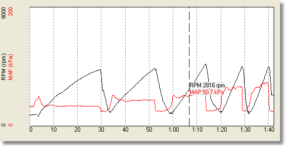

| • | Start datalogging & recording (F9), then accelerate in first gear with a light throttle to 5000 rpm. The aim is to keep the throttle steady so that the engine load stays consistent as the rpm increases. You should be able to see the table tracing running straight down columns 3 & 4. |
| • | After reaching your target rpm, shift into second gear and slow down to approximately 1000 rpm. |
| • | Repeat in second gear with very light throttle. |
| • | Repeat in second gear a number of additional times, increasing the throttle each time slightly to run in a higher column. It does not matter if you go over the same column again. |
| • | Your final datalog should look something like this: |
| • | Notice the straight lines of load, increasing with subsequent pulls. |
| • | The exact rpm range you use depends on your VTEC point. The first and last rpm row tend to have incorrect lambda readings, from throttle tip in and release, so try to datalog from 1000 rpm or so to your VTEC point plus 1000 rpm. Generally 1000 rpm - 6000 is ok. In this example, VTEC is at 3200 rpm, so an upper limit of 5000 rpm is plenty. |

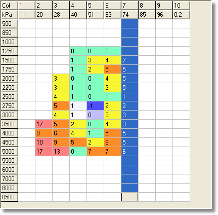

| • | Select 'Fuel Change' (Shift-F3) to show the suggested fuel change. |
| • | The fuel changes should look something like this: |
| • | This shows that the engine is running lean in most recorded areas, and than fuel should be added. |

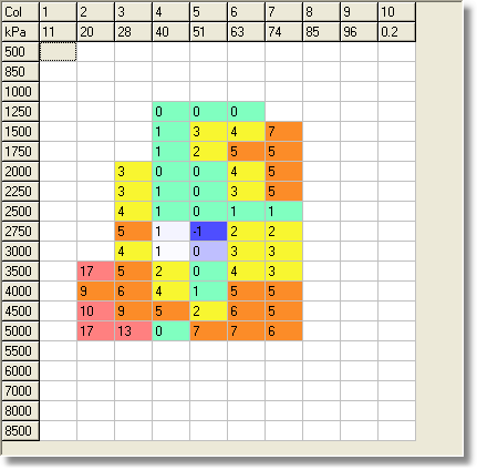

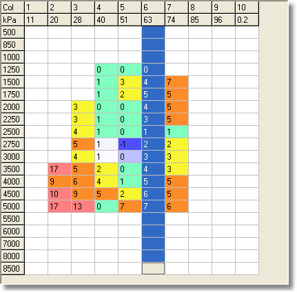

| • | Here we have selected the whole of column 6 and will add 5% fuel. |
| • | 5% fuel is also added to the whole of column 7. |
