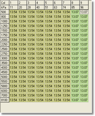

High load fuel At full throttle / high load / open loop, the ECU uses an additional table is used to enrichen the mixture from the stoichiometric calculation used from the AFM.
WOT compensation table
Note that the values in the WOT compensation tables should only be changed within certain limits. The ECU will not switch into open loop correctly if the WOT compensation table values are raised so that less fuel would be required in open loop than closed loop. Generally values should not be increased over the stock values to prevent this from occurring. As a guide, do not set the WOT air/fuel ratio above 12.50:1.
If the air/fuel ratio is not the same as that in the table then the cause is that the stoichiometry calculation using the AFM is incorrect - again the reason is usually that an after market intake is being used. |
