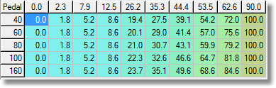

Throttle Index Table Some vehicles use a table to calculate the index to the main throttle table.
This table uses vehicle speed for the row index and throttle pedal for the column index.

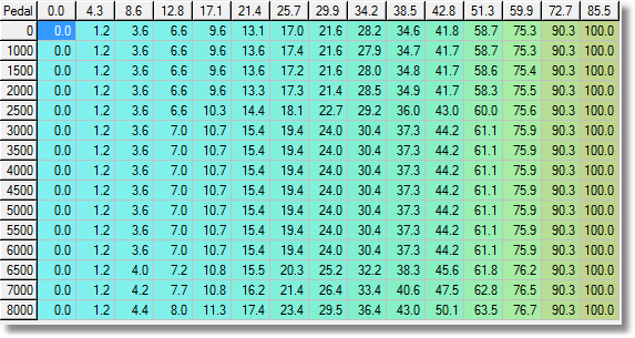

Target Throttle Plate This table maps the relationship between the throttle pedal and throttle plate. The row index is rpm and the column index may be throttle pedal or the value from the throttle index table. The throttle plate is opened less at low rpm for smoothness.
Note that the throttle plate first column values are restricted in order to ensure the throttle plate closes when the throttle pedal is released.

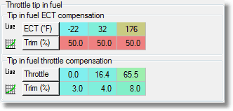

Throttle Tip In Fuel The ECU will add extra fuel when the throttle is opened quickly ('throttle tip in').
Tip in fuel ECT compensation Compensates tip in fuel for coolant temperature. A higher value is more fuel. Tip in fuel throttle compensation Compensates tip in fuel for starting throttle position. A higher value is more fuel.

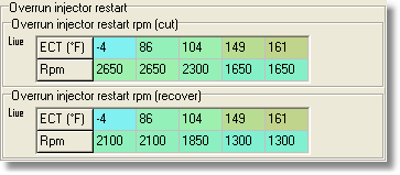

Injector Overrun Cutoff
The fuel injectors are shut off during overrun conditions (deceleration with the throttle closed).
The restart rpm determines at what engine speed the fuel injectors will restart operation. There are two tables to set a hysteresis - the injectors will be switched off when the engine speed is higher than the cut table, and switched on again when the engine speed is below the recover table.

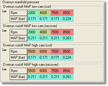

Manifold pressure is used to determine when the injectors are switched off. There are tables for both the low and high speed cams, with hysteresis.
