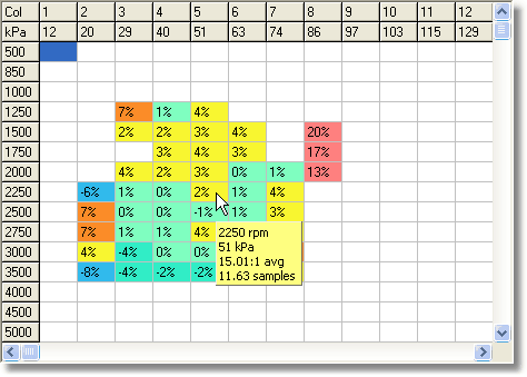

Sensor Overlay |
With fuel tables, lambda (air/fuel) values or other sensor values may be shown ('overlaid') on the table.
For a lambda overlay the tool tip shows the rpm, load, averaged lambda and number of sample used to calculate the average lambda. Note that due to the way sampled values are applied proportionally to cells, the number of samples is not an integer value.
