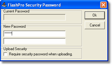

Entering a Security Password
Entering a password Leave Current Password empty, as by default the security password is empty. Enter your new password twice to ensure that the new password has been entered correctly.
Changing Your Password Enter your current security password, or leave blank if no password has been entered, and enter your new password twice to ensure that the new password has been entered correctly.
Removing Your Password To remove a password enter your current password and leave the new password fields empty. Unlocking the FlashPro from the vehicle will also clear the security password.
Upload Security Check Require security password when uploading to ask for the security password each time a calibration is uploaded to the FlashPro. Note that setting this option will effectively prevent the FlashPro from being used on a different vehicle as the FlashPro will not be able to be unlocked from the current vehicle without the security password.
