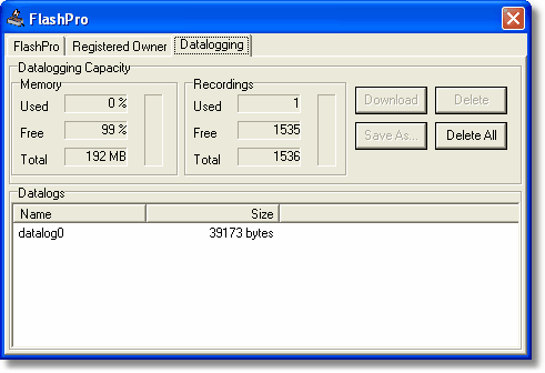

Downloading Datalogs from FlashPro
Once datalogs are downloaded into FlashPro it is recommended that they are saved onto the computer.
Datalogging Rate
The datalogging rate can be varied to give a longer recording capability.
The approximate maximum recording time is 7.5 hours (Fast) and 21 hours (Slow). |
