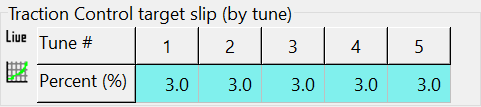

Traction control target slip Target slip can be varied by tune

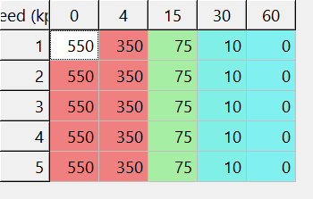

Traction control launch slip Launch slip can be varied by tune. Top index is speed, side index is tune number.

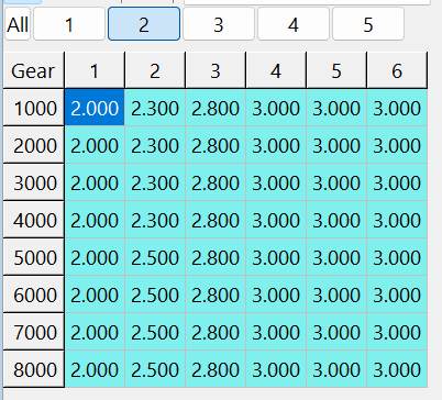

Boost by gear Boost can be limited by gear, rpm and tune. Top index is gear, side index is rpm and the tune number is selected using the top buttons. Values are absolute manifold pressure in bar.
