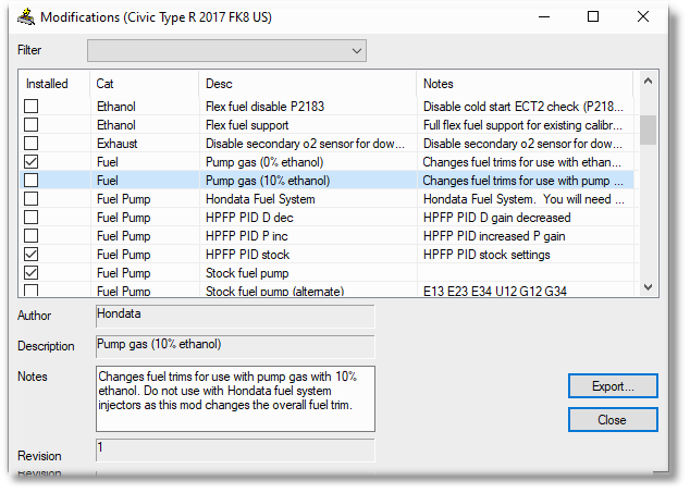

Modifications are a sub-set of a calibration that can be used in any compatible calibration. For example, if you have a custom throttle mapping table it can be imported into any calibration as most of the calibration does not need to be changed - only the throttle tables.
Modifications are accessed from the File menu or on the toolbar. If the Modification menu / Mods button is not shown, then the current vehicle does not have any modification files available.
Modifications Windows
To install or remove a modification, click on the checkbox or double click the modification.
Note that they way modifications work means that they may change several parameters at once, so installing one modification may result in another modification being shown as installed. Also some modifications can be shown as installed on a stock calibration. This is normal.
