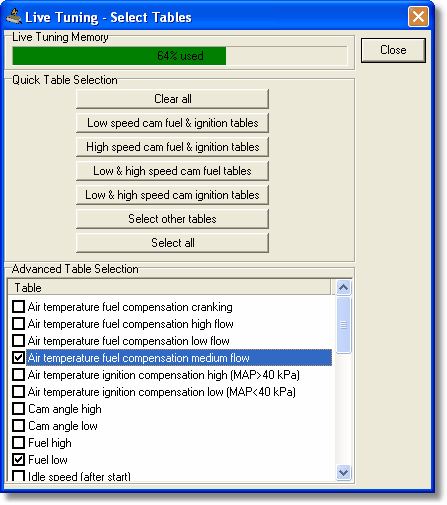

Menu Table Selection Alternately, tables may be selected from a list available from the Online menu.
Buttons allow the quick selection of popular tuning options.
