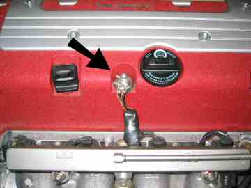

Engine Ground It is very important that the ground from the wiring harness to the engine (G101) makes good electrical contact with the cylinder head. Otherwise the return path for the sensors, ignition and VTEC may be through the OBDII connector, FlashPro, laptop, laptop charger and inverter to the vehicle body, which may damage the ECU/FlashPro.
