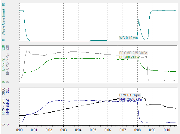

Turbocharger over-speed A turbo relies on intake manifold pressure to limit its speed. If the turbocharger discharge is unrestricted, then the turbocharger will reach an over-speed condition. At high rpm this is likely to destroy the turbocharger and therefore the engine.
The most common cause of turbo over speed is a boost pressure loss from a split or disconnected hose, or leaking intercooler pipes.
Vehicles with a small turbocharger relative to the size of the engine (2018+ 2.0T Accord) can reach a turbocharger over-speed condition with no boost leaks.
![]() Turbocharger in overspeed condition

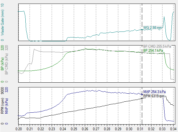

The symptoms of turbo over-speed - boost pressure not reaching the boost pressure target and also the wastegate being closed (near 0 mm). Note that during spool up these conditions exists, but not at high rpm.
![]() Turbocharger in normal operation
Normal turbo charger operation - the boost pressure matches the target and the wastegate progressively opens to limit boost pressure.
