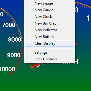

Controls Controls may be added to the window by right clicking on the window and selecting the control to add. Control properties may be edited by double-clicking on the control or by right clicking on the control and selecting properties. Controls may be re sized and moved by clicking and then dragging the control outline.

Clear Display
This menu item will clear the entire display after prompting for confirmation. |
