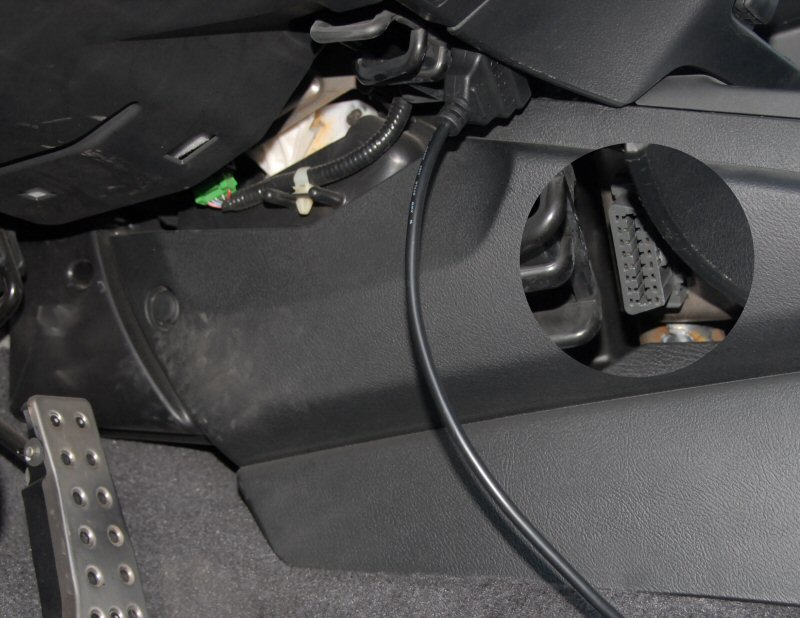

Civic Si For the Civic Si the diagnostics connector is located on the drivers side of the center console.

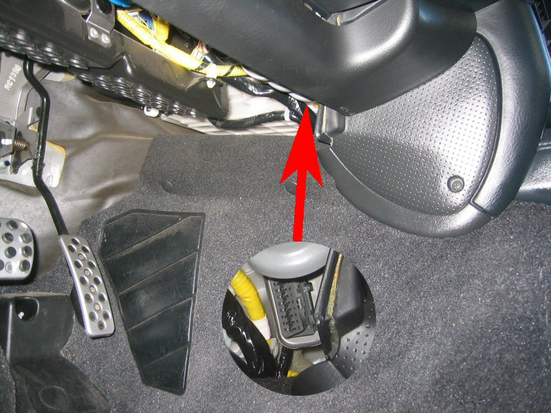

S2000 For the S2000 the diagnostics connector is located on the drivers side of the center console, a line with 'OBDII' molded into the plastic under the steering wheel.

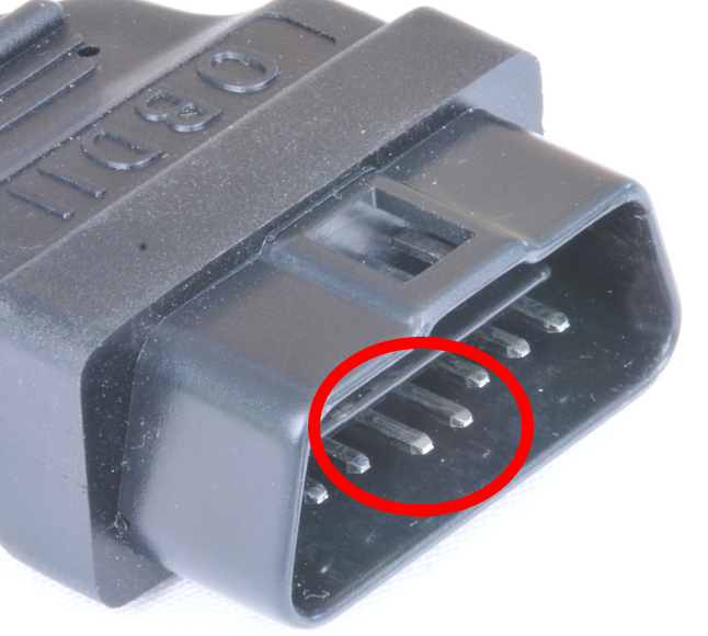

OBDII Connector The OBDII connector has two ground pins which protrude further than the other pins. Please do not try to 'fix' the pins by pushing the grounds pins back into the connector housing.
