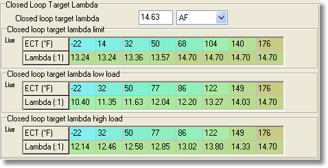

Closed Loop Target Lambda This controls the target lambda (air/fuel ratio) when the vehicle is running in closed loop. A combination of tables is used the set the target lambda, based on temperature and load.
The target lambda used is the richer (lower lambda or air/fuel ratio) of the 'Closed loop target lambda', 'Closed loop target lambda limit' and one of the 'Closed loop target lambda load' tables. The transition from low to high load is at approx 50 kPa.
Warning: Running leaner than stoichiometric (lambda 1, approx 14.6:1) will increase exhaust gas temperatures. For this reason it is not recommend to change these parameters for vehicles with catalysts.

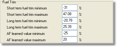

Fuel Trim Min/Max This controls the minimum and maximum percentage of short term and long term fuel trim the ECU compensates for while in closed loop.
The AF learned value minimum and maximum control the range for the stored short term fuel trim value. This value is calculated from the average short term fuel trim over 20 minutes, and is used by the ECU when switching from open loop to closed loop as a starting short term fuel trim. |
