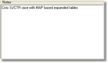

Notes The allows text notes to be saved with the calibration.

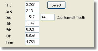

Gear Ratios The transmission gear ratios can be set here. This is necessary for the correct operation of cruise control if the ratios have been altered from stock.
In most vehicles the speed sensor works from the third gear countershaft. If either the final drive or third gear is altered, but speed recorded by the ECU and sent to the dash / gauges will be incorrect. This also occurs if a similar gear ratio is used with a different tooth count. In this case the number of third gear countershaft teeth can be specified in order to give the correct speed reading. Note that in many cases you still will need to use the speed adjustment to correct the dash speed.
